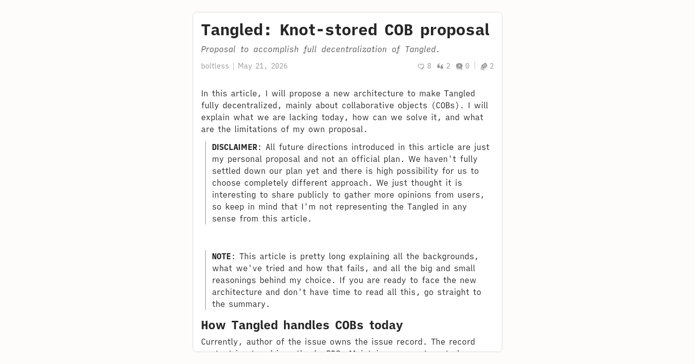

I haven’t read through the whole thing yet, but this leaflet by Tangled touches on the challenges that exist because there’s no such thing as community-owned / access controlled data:
What if Bob nukes his account? Suddenly all bob’s work to that repo will disappear from entire network. This should not happen and obviously not an expected behavior in collaboration platform. For example, we don’t expect old contributor to be able to nuke all their codes and commits from the project without permission just because they want to. Current Tangled appview is working fine because we use our own DB as a source of truth collecting all events in real-time since the very beginning, validating them just as we received them.
So in general we have this issue where ATProto only has a concept of personal data, and there is no facility community / organization data. Personal data is simple, because you never need to do write access control beyond checking whether you are the PDS owner. It is hard to make an access control mechanism that works for every application, especially when every app can make its own lexicon which has its own semantics and needs its own access control rules.

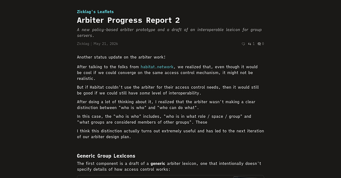

Experimental Community Arbiter Service
So the solution that we’re working on is a generic authorization service that can sit in front of a PDS and provide access control for public ATProto repos, as well as act as a space host and provide access control for permissioned repos.
I’ve almost got a working prototype that uses the Rego policy language to let you create completely custom access control rules.
It works almost like an XRPC proxy that can be associated to a community / org DID and presents a standard ( work-in-progress ) API for managing group membership compatible with the permissioned space proposal.
It can then use that group membership in order to make policy decisions about who can write what to the public repo and permissions spaces, under that DID’s authority.
The cool part about this is that it lets us move authoritative data back on protocol, while not sacrificing on access control. The Rego policy is extremely flexible, and can even make XRPC requests to remote servers in order to determine whether access is granted for a particular request.
We’ve been calling the service the “arbiter” and I’ve been writing about our plans for it as it has developed, but I don’t have a good writeup on the latest plan with the Rego policies. You can see how the idea has been evolving by following the chaing of Leaflets if you want:
I’ve almost got a working prototype where you’ll be able to create new community / org accounts and control access to the public ATProto repo of the account with a customizable policy. It should also be able to act as an alternative to https://opensocial.community.
There’s a lot to figure out, but we think we’ve got a good base and are ready to start experimenting with actual use as soon as possible.
A great part about ATProto and the permissioned data proposal, in my opinion, is that it leaves the door wide open for us to do create things like making a custom arbiter for community data.
If this were to be specified in the protocol itself, then people would be forced to use a particular form of access control that may not work for everybody. But because it is left unspecified, we are able to come up with our own solutions.
Having to come up with our own solutions isn’t always the nicest, but I appreciate that we aren’t forced into a paricular model, and even if some people use our arbiter, since it is built on top of the existing protocol, other apps can be minimally interoperable with it, even though they may not know about the specifics of our extensions on top of the protocol.

Absolutely! I was experimenting with some lexicons that we might be able to share between our arbiter and Habitat’s, but I think we definitely need some more real experimentation before we can really figure out what a common layer might be.
Super excited about the possibilities, though! And we’re really close to having an arbiter implementation we can play with so hopefully that will give us more concrete stuff to work off of.
