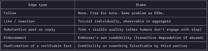

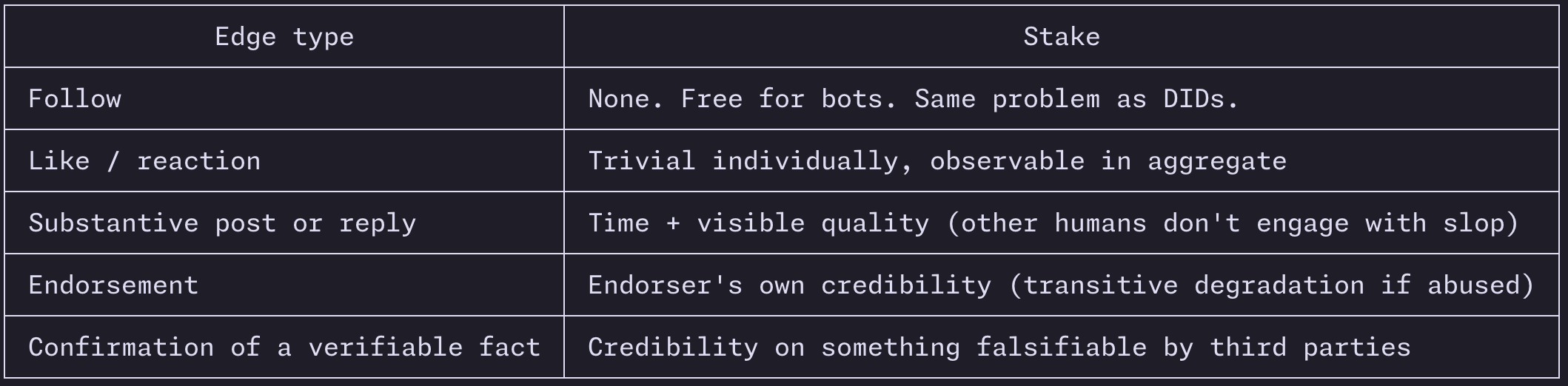

For shared-PDS users, the cost-aligned layer I can find is the activity graph, but only at edges where the issuer stakes something.
Tiered roughly by stake:
Plus two compounding multipliers:
  1. Time. Substantive history weighs more than fresh activity, regardless of edge type.
  2. Cross-lexicon activity. Real users drift across multiple apps over time (microblogs, Sifa, roomy, atmo.rsvp, offprint, grain.social, etc.), with rhythms that vary, bursts and dormancies, and traces that mutually reference each other: Your atmo.rsvp says you went to an event, your Bluesky reflects it, your Sifa shows endorsements from people you met there. Faking this plausibly is qualitatively harder than faking activity in any single app, and atproto’s open ecosystem is what makes that cost transferable across surfaces.
An attacker can of course still flood the graph with follows + likes from accounts they control, but those edges carry no trust weight because the controlled accounts themselves have no inbound trust from established users. Stake-bearing edges (e.g. endorsements, confirmations, substantive engagement) require a third party the attacker doesn’t control to act. That action has cost, whether through account compromise, social engineering, or payment. None of those scale to ā€œmillions of identities for $10.ā€
