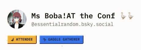

Challenge: we want to support both types of badges:
Icon + colors badges, easy to create for people who just want to put a badge out without thinking too hard about it (I’m told they exist)
Image Badges, for the rest of us who miss the geocities era. Let’s take one of ours, for reference:
Fields:
title: display title for the badge.
displayDescription (optional): display description for the badge. Can be longer than original badge description. Falls back to community.lexicon.badge.definition#description if not present.
image (optional): visual representation of the badge. Like Bluesky’s, it has alt, image, and aspectRatio (but flattened).
icon (optional): an emoji or character or small image that represents the badge (e.g.
, ⌘, or an actual image). If not defined, falls back to first letter of the title. Personally, I’d allow 2-3 graphemes with the understanding that it may be cut to 1.
accentColor (optional): primary color of the badge (leaves door open for distinguishing background + foreground combinations in the future).
url (optional): where to go to learn more about the badge (can be an actual URL or an ATUri).
Important: image and icon/accentColor are not mutually exclusive. icon can be used to represent the image in space-constrained environments. But when possible implementers should prefer image and consider icon/accentColor a fallback
