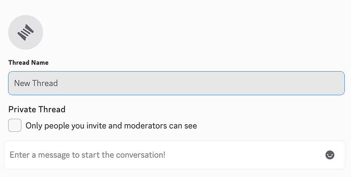

I noticed this capability in Discord today, I think it represents a pattern more broadly useful

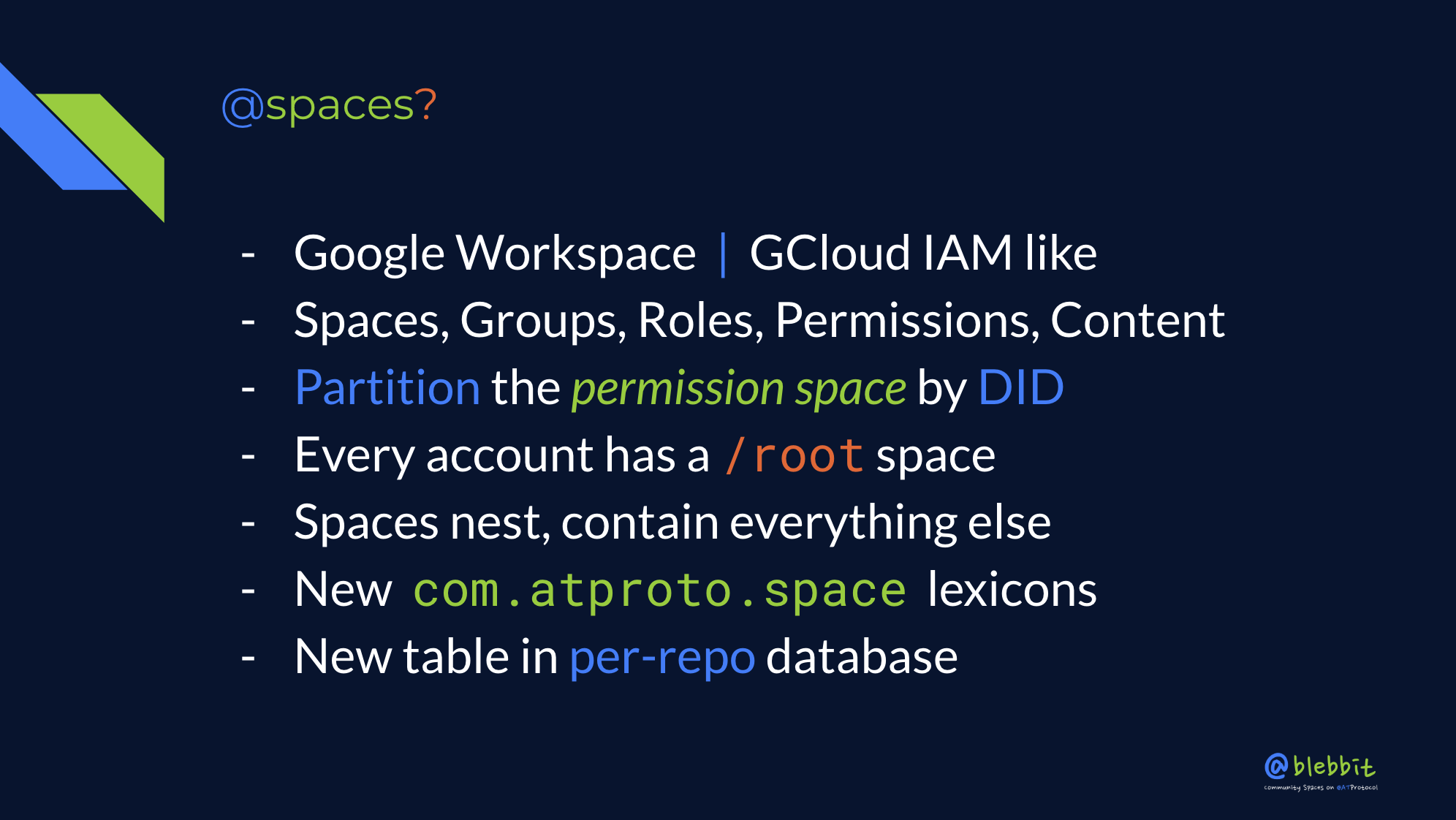

working on a slide deck for my stuff, how is this one-pager for “what are spaces?”
(context, someone who already has context of what we are working towards)

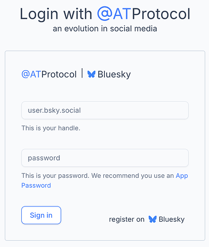

wrt OAuth, I may be asking the wrong question, or presuming something I shouldn’t. When I click the @ ATProtocol in the upper right of the blebbit.app I see the following login prompt.
I assume since it is asking for my password, it is not using OAuth (I expect OAuth to send me to a bsky.social login page?)
oh, yea, that’s old code from March before I implemented OAuth for Blebbit in Authr
When I have enough of the PDS permissioned spaces implemented, I’m switching Blebbit over at which point it will get the OAuth treatment
