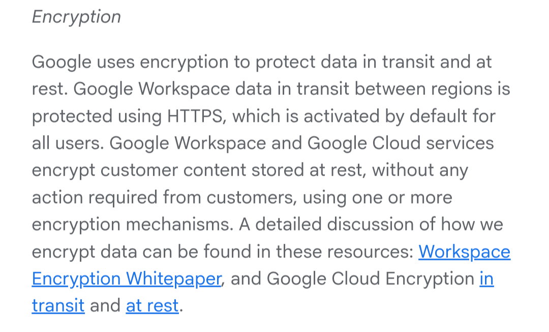

When I use a PaaS, they encrypt the data at rest and in transit, including the VM disk, the shipping of logs, and the storage of logs. I do not have to put luks on the VM and encrypt logs myself before shipping them
”For example, you can use the AWS Encryption SDK with an AWS KMS Key created and managed in AWS KMS to encrypt arbitrary data.”
Just to clarify, you prev mentioned:
”if I use a cloud vm, most of those are compliant because my provider is managing encryption at rest.”
The answer remains no. You need to know the systems you are using and understand, on a case-by-case basis, how to adhere to the regulations in place. AWS has 90% of the market and is telling you, “We are giving you the option, but this is your responsibility”. You might need to luks /var/log if your provider doesn’t give a similar option out of the box.
