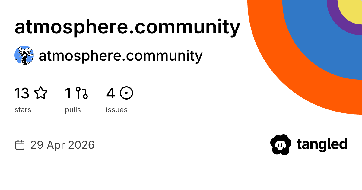

It’s a community project as is atmosphere.community
Atmosphere Community isn’t really styled yet and is where we could experiment with integrating design tokens.
