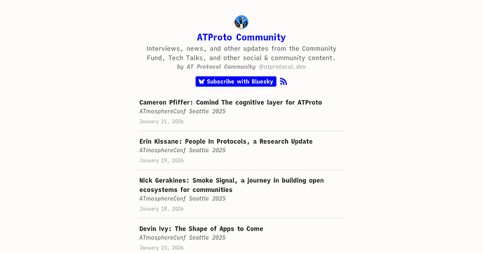

We’re keeping it pretty simple and just grabbing transcripts from YouTube and posting them to our leaflet.
@lucca.northsky.team is doing that work, as part of the conference producers team.
We also have the source video from AHOY and ATProto NYC that we haven’t processed yet.
Given source video in YouTube and some unposted in GDrive, and the fact that we embed in Leaflet, can you suggest how to put these pieces together?

Leaflet doesn’t currently support arbitrary HTML. But @schlage.town @awarm.space might be convinced to add support.
@maboa.bsky.social this might be something we can add to the 2026 conference website, and in fact, retro-actively make it the archive for talks and events. Happy to walk through that and accept a PR to experiment with this but also in crunch time for the conference.
