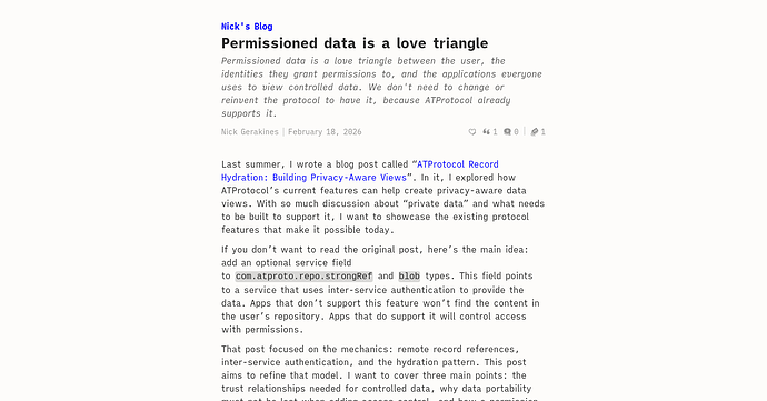

Creating a space for discussion for the recent post:
Awesome, thanks @ngerakines.me
I moved it to WG Private Data – which I think I do need to capitulate and rename to “Private & Permissioned Data” ![]()
Really great write up, thanks for putting the time into this.
Hi Nick,
Thank you for this write up!
