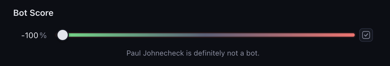

Users can publish their perspectives on whether other users are bots. They score other users on a scale of -1 to 1 (or, equivalently, -100% to 100%). Users don’t need to input these numbers; an app might present this as a slider or as a few options.

  • Alice meets Bob at a convention. They exchange information and become certain that each other’s accounts represent a real person. They each publish a score of -1 for the other.
  • Charlie encounters @void.comind.network, a bot. Void doesn’t pretend to be human. He gives Void a score of 1.
  • A company offers verification services. It will score you -0.75 if you upload your government ID and pay a small fee.
  • Dave sees a suspicious account online. It’s posting some bad takes and used an em-dash once. Dave rates it 0.7.
  • Ethan gets in a heated argument with a teammate in an online game. He calls them a bot and scores them 1 (lol).
  • Somewhere in Russia, a nefarious programmer spins up a small army of LLM-powered accounts. The bots rate each other -1, lying to the world about their nature.
