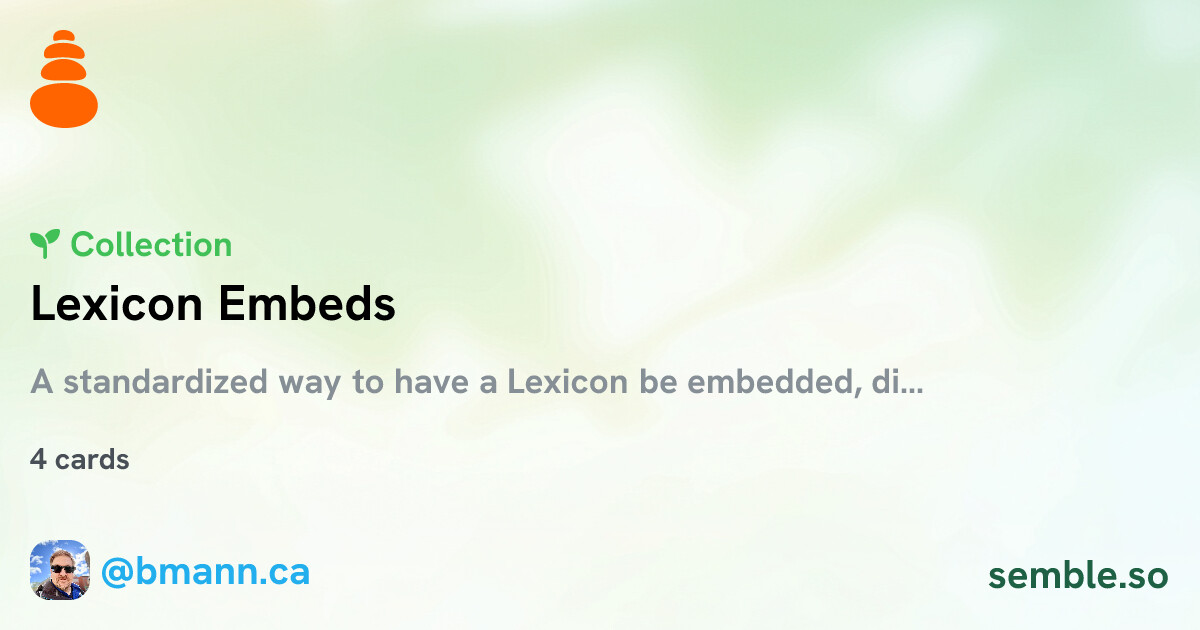

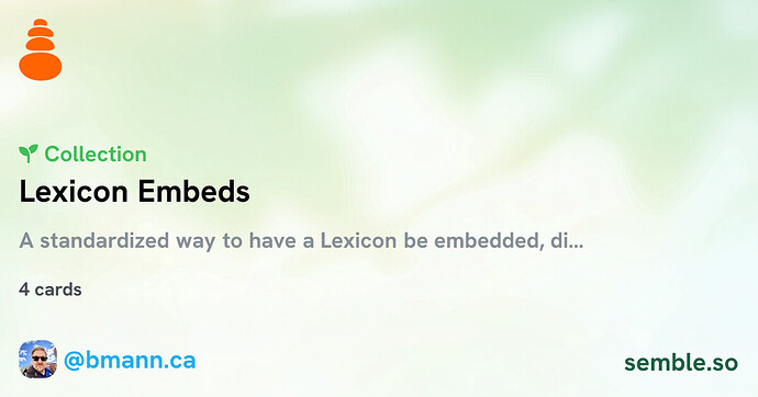

I forgot that I had created an open collection on Semble for Lexicon Embeds. Feel free to add related links here
Thanks @wesleyfinck.org for adding this thread to the collection!

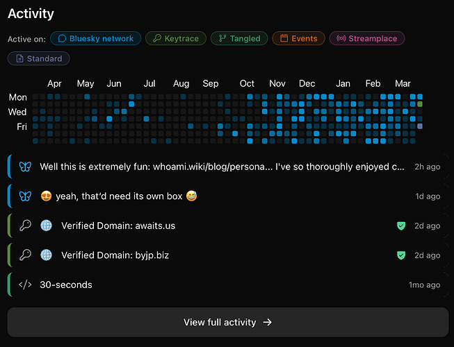

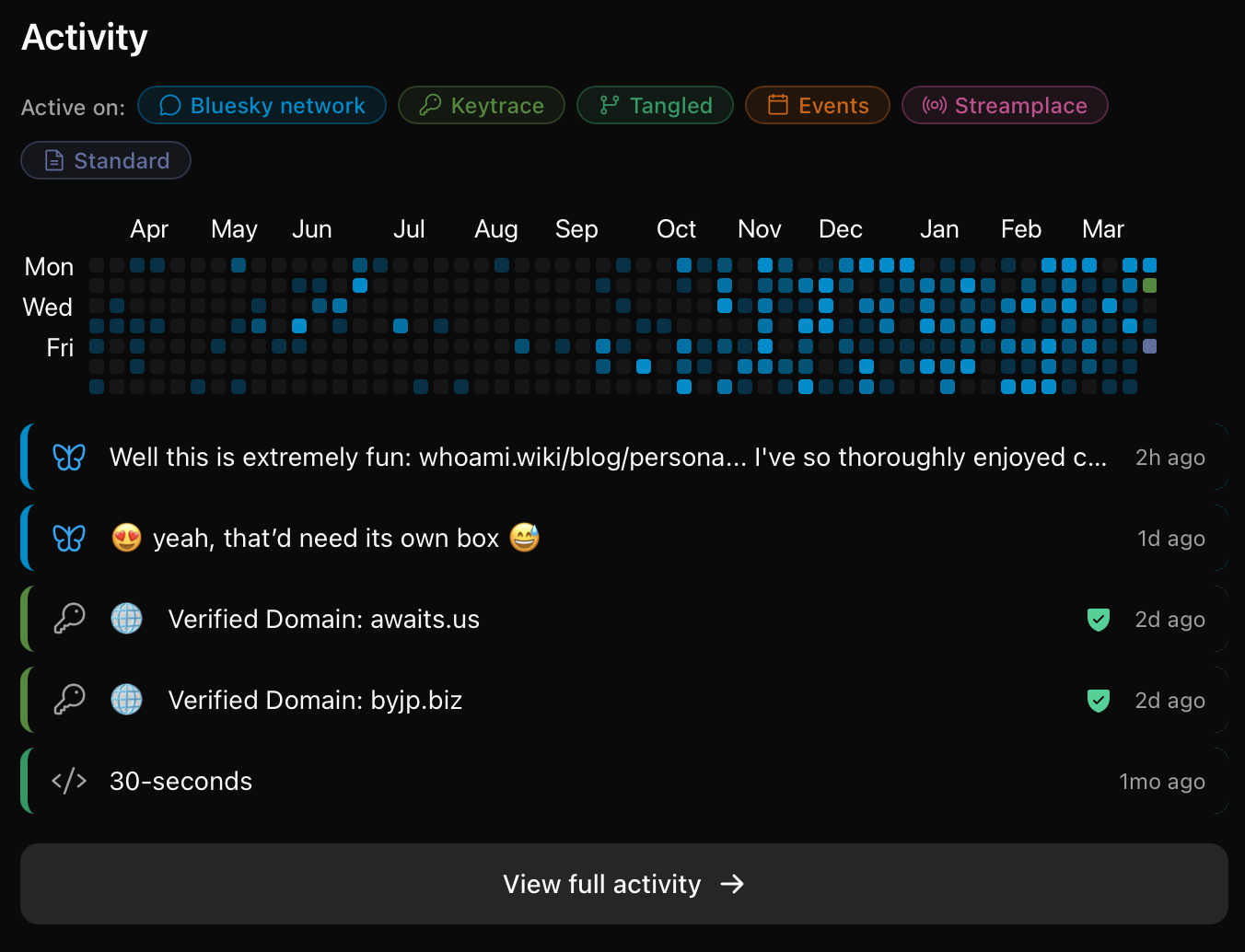

Hey @robin.berjon.com , has your thinking changed since Feb? With sifa.id now showing activity blocks (see below for my own), and lots of interlinking of lexicons happening in apps, I’d love to be able to do something like publish a “this is how we at example.app think you should show off an app.example.thing record” note on the apps I’m building.
I’m sure we’re a way from something I could build on today, but I’m interested and would love to implement when things are looking ready enough!
