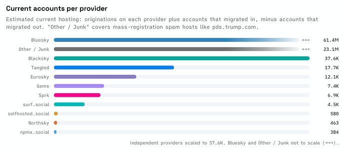

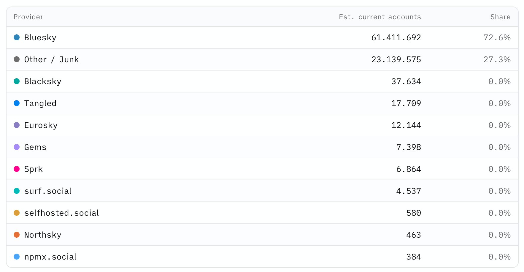

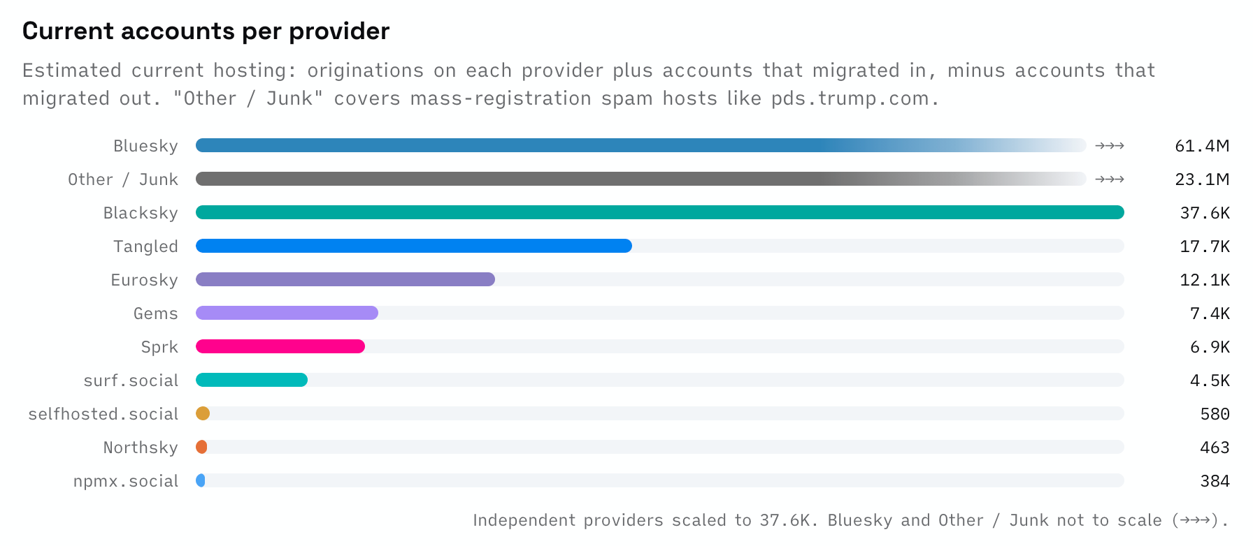

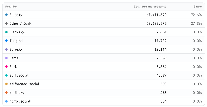

FYI: now also added current accounts per provider….

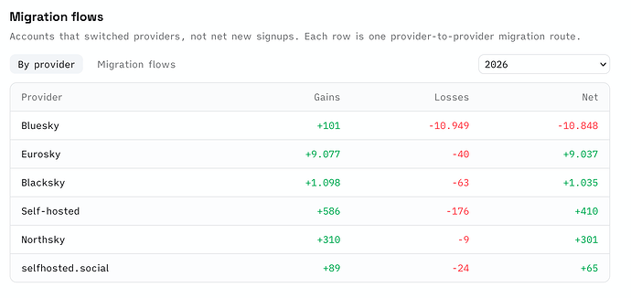

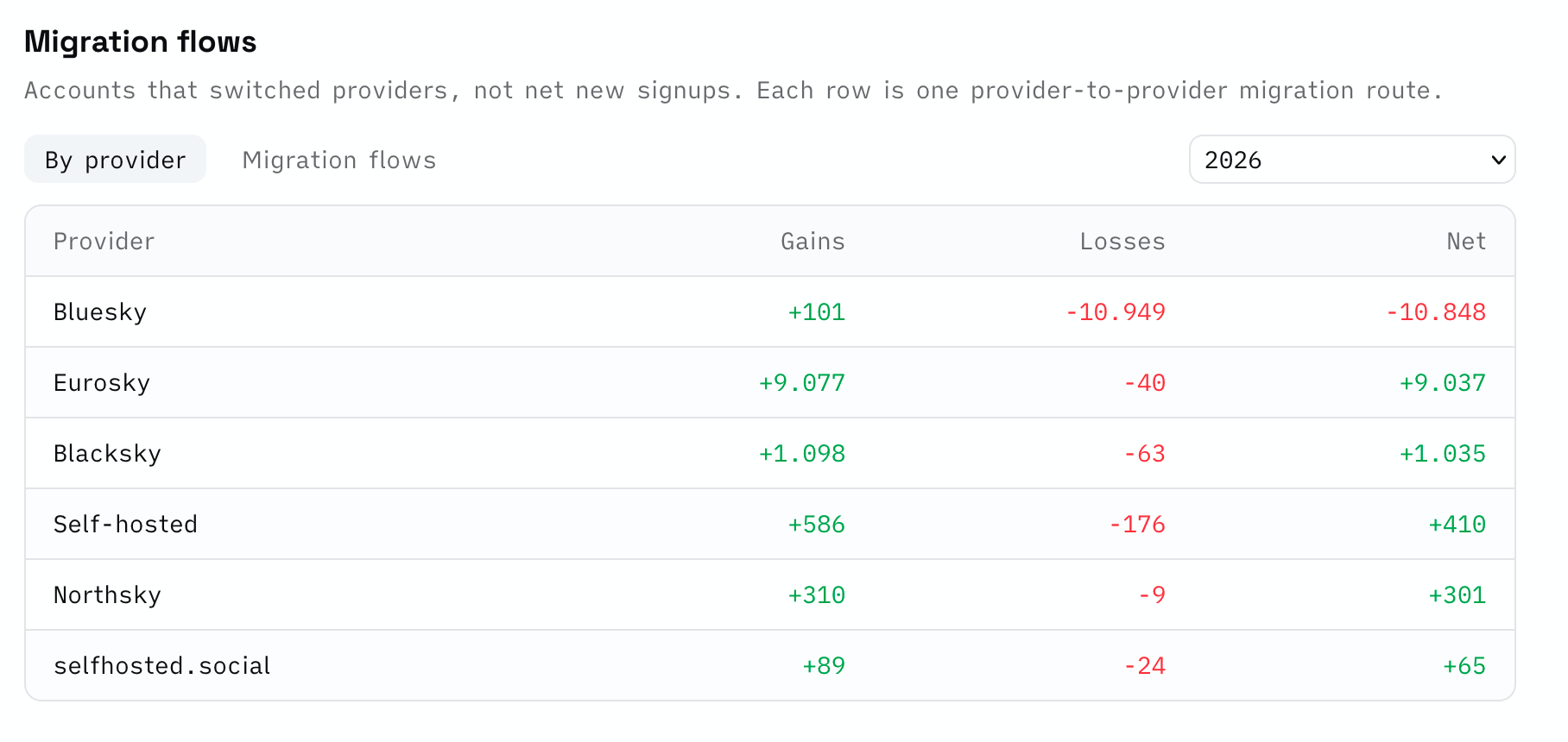

… and migration flows
